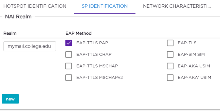

    Realm. The NAI (Network Access Identification) Realms list is a FQDN (Fully-Qualified Domain Name) of the service provider. This is a list of realms that can be successfully authenticated. Each realm may have up to four supported EAP methods.
    Wildcards are supported. For example, for realm, you can enter *.extreme.area120.com, instead of entering specific realms.
    To add realms:
    1. Select New.
    2. Enter a value in the Realm field. The NAI Realm is a FQDN of the service provider.
    3. Select the EAP Method.
    Realm Configuration

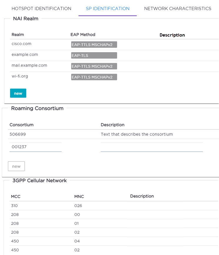

    Roaming Consortium. Configure authentication of mobile devices to the members of a roaming consortium, or for a particular service provider that has a roaming consortium. Add the appropriate IEEE-assigned Organizational Identifier (OI). Specify up to eight identifiers unique to the organization that are part of the MAC address.
    The order of the roaming consortium definition is important and it is preserved during configuration changes and system upgrade. The AP39xx access points continue to support only two identifiers. The AP39xx receives the first two identifiers in the list.
    Use roaming consortium authentication when you do not know all the authenticated realms. Using identifiers unique to the organization in the beacon is a battery efficient roaming method because there are no ANQP queries needed.
    3GPP Cellular Network. This is a list of cellular network IDs in the form of mobile country code (MCC), mobile network code (MNC). This list establishes whether an AP has a roaming arrangement with the 3GPP service providers.
    1. Select New to expand the 3GPP Cellular Network pane.
    2. Enter the MCC and MNC values.
    3. Provide an optional description. The Description field supports up to 32 bytes and UTF-8 format.
      The New button remains unavailable until valid values are entered in both fields.
    4. Select New to accept the entered values and open a new row.
